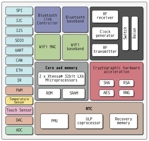

Opportunities for development include both extensions to the core framework (such as for new notification mechanisms, new protocols, etc), as well as adding support for new types of vehicles or extending the supported functions in existing ones. While core functionality is usually developed in C++ using the Espressif IDF, OVMS also includes a JavaScript engine for powerful scripting.
![](https://www.openvehicles.com/sites/default/files/glazed-builder/esp32.jpg?fid=3010)
