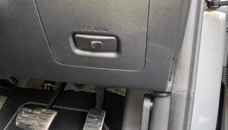

For me, I think the solution is to get into the habit of turning off OVMS when I am not using the car.
Here is my switch solution:
