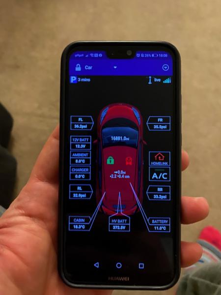

And this is what i see on android
I tapped the buttons on the android app and it all worked.
Any idea why this could be and if this is a know problem when it will be resolved?

thanks a lot LindseyP i have
thanks a lot LindseyP i have found out that this actually works it just does not have indicator as on the android app to show when the ac is on or off.
but as long as i  can remotely start the ac on and stop it I am happy.
