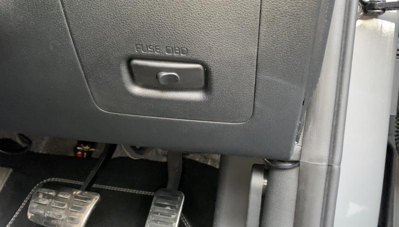

You should also be aware that
You should also be aware that the issue is not really that the OVMS unit drains the 12v battery as its power draw is very low.  The actual problem on the Hyundai / Kia vehicles is that the OVMS keeps several of the cars ECUs active preventing them from going to "sleep" properly and in fact the cars own systems drain the battery.  Adding an additional battery to keep the OVMS alive will probably not help your situation.  SInce the more recent software updates in the car, the "battery saver" option that used to exist in the menus has been replaced with permanent feature where the car wakes up every 4 hours to top up the 12v battery so the problem might not be as big a concern as it used to be.
I have OVMS on a Hyundai Kona (which is essentially the same as your Niro) and I just have a simple switched OBD cable to power the OVMS on and off.  I power it on when I get in the car and power it off when I am back home.  It is safe to power on at the beginning of a day of running about and leave it on all day, powering off at the end of the day (for example):
