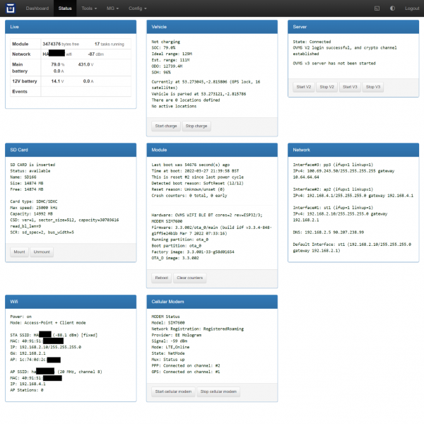

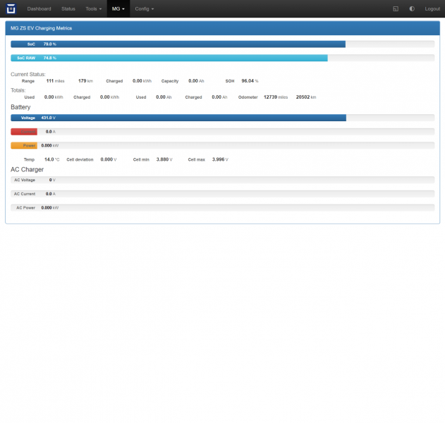

Both these screenshots were just taken whilst the vehicle is on charge:

After contacting support, they provided an easy fix.
I was using the EU ovms.dexters-web.de server.
I changed this to the global api.openvehicles.com server and since then it has been working great.
It shouldn't matter which server you use, as they are equivalent. But you do need to make sure both the App and the Car module are set to use the same server.
