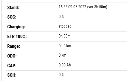

And also only GPS location was correctly transfered to server. All other values (e.g. SOC) were 0, see
Question: Is the Firmware (3.3.002) and configuration (MG EV (UK/EU)) only possible for the "before facelift" models? Or is there another issue or setting I missed? Which log file could help?

After changing the Vehicle fromm UK/EU to TH and driving a few hundred Meters, now Speed, Pressure, Temperature, ODO etc are updated. But: Still no information (SOC, SOH, Temp) about the Battery.
I don't think anybody has done any work on the facelift models yet. It sounds like it will need a lot of probing and coding by someone who owns one.
