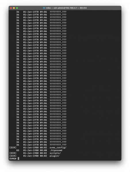

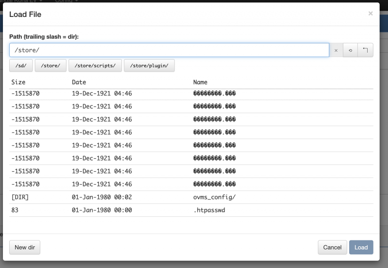

I have noticed a number of files listed in the VFS as /store/ directory as ????????.???
This is also reflected when listing from the shell:
vfs ls /store
Has anyone else enountered this issue or can they offer any insights?

This is a known issue, can happen occasionally. Backup, factory reset, restore. You may need to restore from a previous backup.
