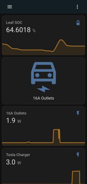

I really want to get battery SOC into my Home Assistant instance and here in New Zealand there is no option of using the Nissan Connect api etc....
So I'd really love if someone could crack this issue and get the Leaf supported :-)
