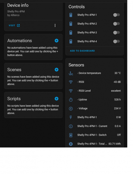

After a while I disabled my Shelly 4PM switch, effectively removing power from the wall charger, but the module still reports "topping off"...
