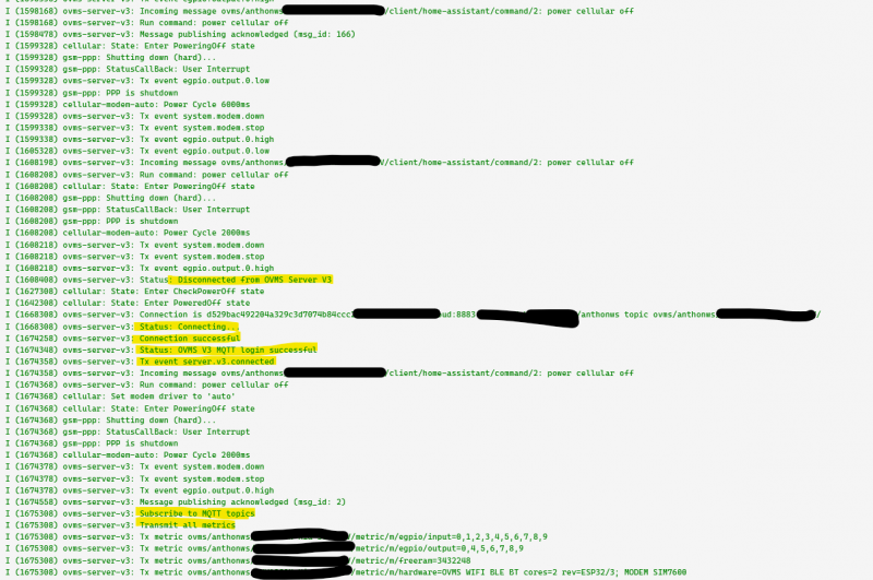

I am automating things with Node RED, to save some power draw from the 12v battery, like location of car, WiFi connection, etc.
When the flow decides to power off the LTE modem, Server v3 connection drops and is re-established.
Why? If WiFi is connected and set as the main provider?

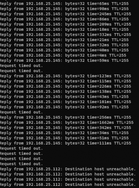

Ping would fluctuate on and off, demonstrating something alike a boot loop or network service boot loop. Removed the module from the vehicle and did a factory reset (actual already did several and flashed the latest edge to both OTA partitions).
I can repro every single time, that after adding Server v3 configurations and starting the service I lose access to the module...

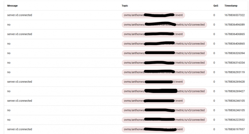

Ping goes back again to the same behavior (replies, time out, and replies again) and in my Cloud MQTT service I can see a constant set of messages of server.v3.connect...
