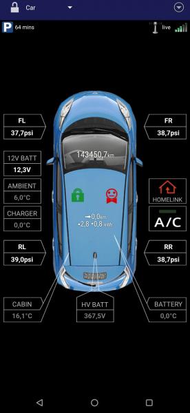

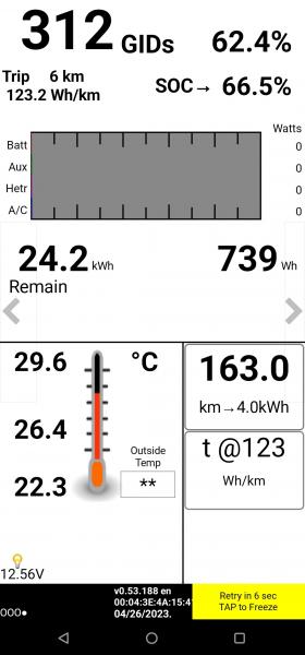

Hi. I changed the battery in my leaf from 24 to 40 kWh. After finishing the work, I noticed that OVMS stopped seeing the battery temperature. LeafSpy sees the temperature correctly. Can you help fix this?

I have the same issue on my ZE1 40kWh
I have OVMS running on my ZE1 and I also don't get the battery temperature coming through. Hopefully if someone can help sort this out for you, I can benefit too.
