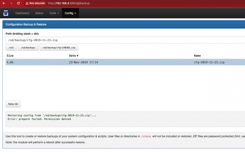

However, now I am unable to restore from backup, getting the following error: "Error: prepare failed: Permission denied"

Not sure if it is related, but I see this in the console logs after trying to restore backup:
I (87723) webcommand: HttpCommandStream[0x3f8b4c9c]: 3512644 bytes free, executing: config restore /sd/backup/cfg-2019-11-23.zip [redacted password]

The message would indicate
The message would indicate some problem writing to the /store FAT file system. You can check with the shell whether that file system is readable (vfs ls /store) and writable (vfs mkdir /store/test). if not, then the only solution is esp32 tools to wipe the partition.
