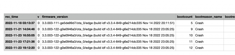

Looks like 122 is generating a lot more crashes. Any way to troubleshoot and send logs for analysis?
I also started losing access to the module, even via WiFi (gets non-responsive). Need to disconnect and connect again. Glad to collect info.

Thanks for reporting, but your crashes are unrelated to firmware changes, there were none in generally used code and none in the Kia Soul module from -122 to -130.

So, what could explain those
So, what could explain those crashes? WiFi? Power? LTE? Is there something I can do to evaluate possible root cause?
