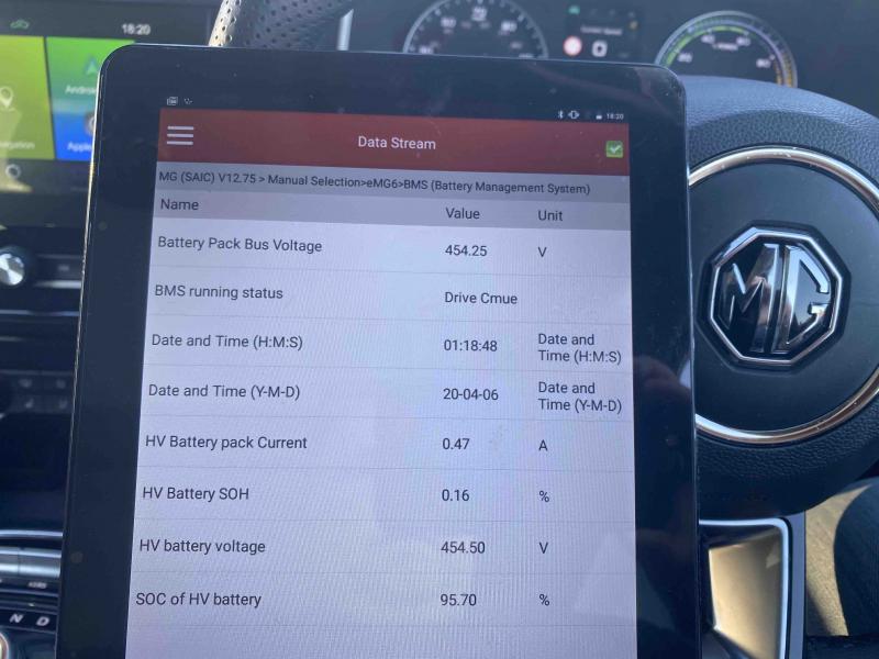

Launch Diag software or X431PRO with complete database 2017/2018 onwards (including CHINESE CARS - in our case MG (SAIC)) will let You to scan/control body ECU, restrains, HVAC and some other stuff - this means You can open/close windows, turn on/off HVAC, adjust fan speed and temperature or have value reading from these units. This means that we could potentially have a device/software (OVMS) talking to the car and controlling some functions - only thing we need to use right communication protocol and send the right request to the right ECU. As i had only Launch/X431PRO S3 with database til summer 2019, i could not talk to BMU (battery management unit) as MG ZS EV was non officially existing at that moment.

That sounds very promising. It will most likely be an OBDII style request-response poll.
If you use an OBDII T or Y cable, connecting both OVMS and your diagnostic tool at the same time, you should be able to log the requests/responses (so long as they are over CAN bus).

MG BMU SCAN
Hi ALL
This picture proves that newer version of software i mentioned previously is working perfectly well over main OBDII connector. Still have not received OBDII Y cable splitter so can not take any logs live using my OVMS yet. I'm not a software developer so any help with rest of it once have logs is welcome.
