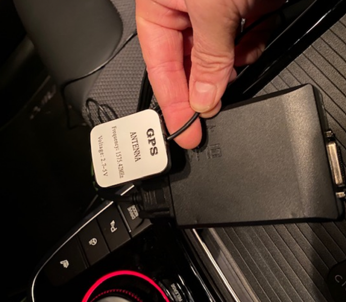

Hi
I have just setup and installed my OVMS and everything went fine.
But I do not get any GPS location data from the device on the server / app.
I have tryed to remove the antenna and putting it on again.
Is there somewhere I can se if the GPS is working or what the problem could be.
Thanks, Javaman (Kia E-Niro)

Which antenna do you use?
Hi, The one from (https://shop.openenergymonitor.com/ovms/)
That's the standard GPS antenna (active) and should work. You possibly have a hardware issue. The most typical source for this is the pigtail cable.
If you can't check the antenna and don't know how to check the voltage & pigtail cable, you'll need to send the kit back to OpenEnergyMonitor for a test / repairing / replacement.

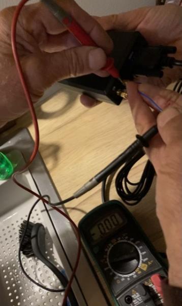

No voltage from the gps
and the antenna cable is ok

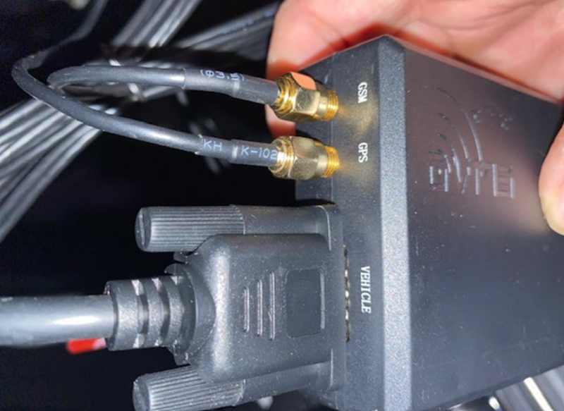

You should see ~ 4V there. As your modem is working, the next thing to check would be the pigtail cable.
Open the module, trace the cable from the GPS socket to the modem PCB. Check if it's connected tightly on the PCB socket. Try disconnecting and reconnecting. Test if the cable is broken.
No problems with the cable from the print to the connector.
so the problem must be in the printboard.

One comment on testing antenna connections, is that the following tests can be done with a mulitmeter:
Regards, Mark.

FYI: I've had the same problem as the OP (also same antenna). I've opened the case and dis- and reconnected both antenna cables. I guess I would have only done that for the GPS antenna but I wasn't sure which was which. I've also dismounted the modem board which was most likely unecessary. After reassembly it worked.
One stern look in the direction of QA... but now it works which is ok.
